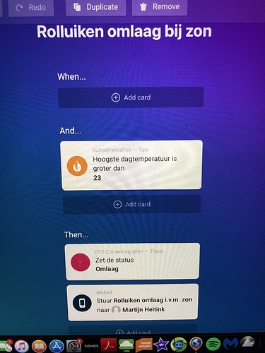

Yes, but then the roller shutter will close not earlier than when the actual temperature is above 23 degrees. What I want is that they close if the expected temperature of that day will be higher than 23 degrees.

I made this flow, but when I test it, it says there is an error. Don’t know why.

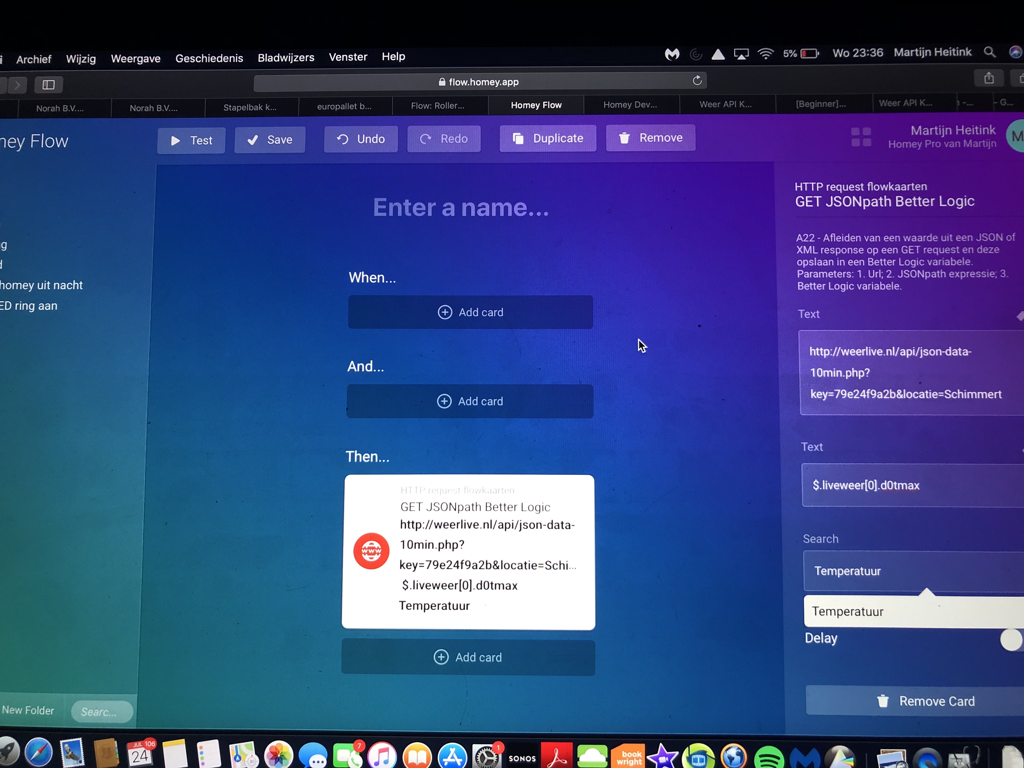

Get a key here. Make a flow with Better logic. Make a better logic variable and call it whatever u like. Make a trigger at any time of the day. For the THEN part we pick the HTTP flow card: GetJSONpath Better Logic. Top txt will be:
http://weerlive.nl/api/json-data-10min.php?key=demo&locatie=Amsterdam
Plz change ā€œdemoā€ with ur own key and change the location.
2nd txt will be:
$.liveweer[0].d0tmax
At the end u find the variable u just created.
There u have the expected temp for today in a flow.
If u want the max temp for tomorrow pick d1tmax :wink:
Now u can create a flow with a time trigger AND logic tag>23 THEN…

Oke, I tried to make the flow as mentioned above. What is the following step?
This is the English part of the forum so you should ask your questions in English.
What you did in the screenshot is to have the temperature put into the Better Logic variable. In the When field you could input a card like (at 6:00) or (every 60 minutes) or something like that so the variable gets updates at least once every day (at the beginning of the day).
Then you’ll need a second flow where you compare the temperature in the variable and based on that close your roller shutter.
