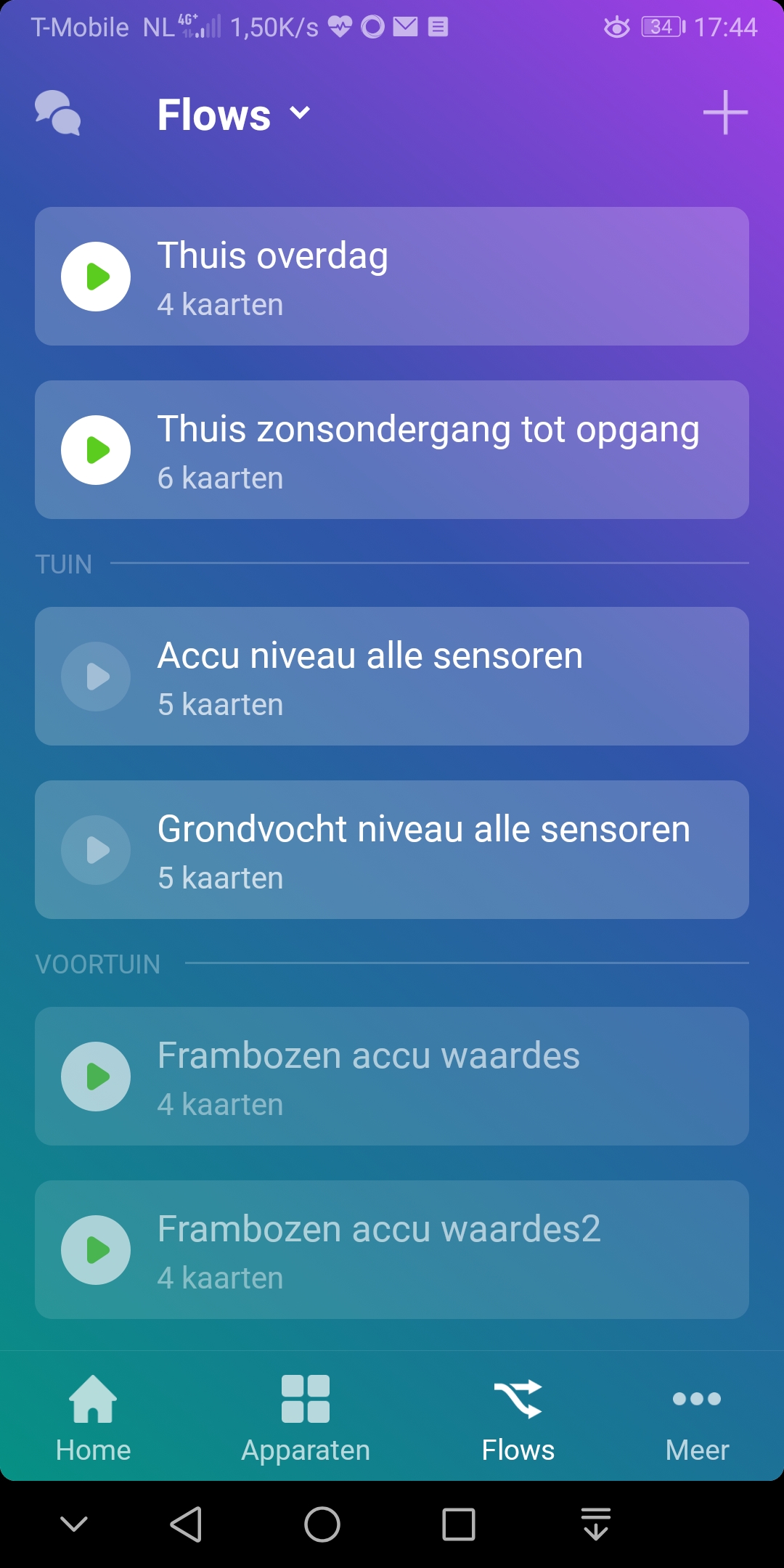

I have another one, which is less clear white, so what’s that. I have 3 different ones. See screenshot
According the also grey’d txt there are disabled?
The last 2 can also be run manually. So as a homey noob… I have no clue at all :rofl::joy:
First 2:
Green play button, not faded.
Flow enabled, and is able to run, by for example pressing the play icon or from favorite flows.
Middle 2:
Grey play button, not faded.
Flow enabled, and is not able to run by pressing the play icon, because the flow needs/uses a value of the trigger card.
Last 2:
Green play button, faded to 50% opacity.
Flow (trigger) disabled, and is able to run, by for example pressing the play icon or from favorite flows.
And 1 more situation not shown:
Gray play button, faded to 50% opacity.
Flow (trigger) disabled, and is not able to run by pressing the play icon, because the flow needs/uses a value of the trigger card.
