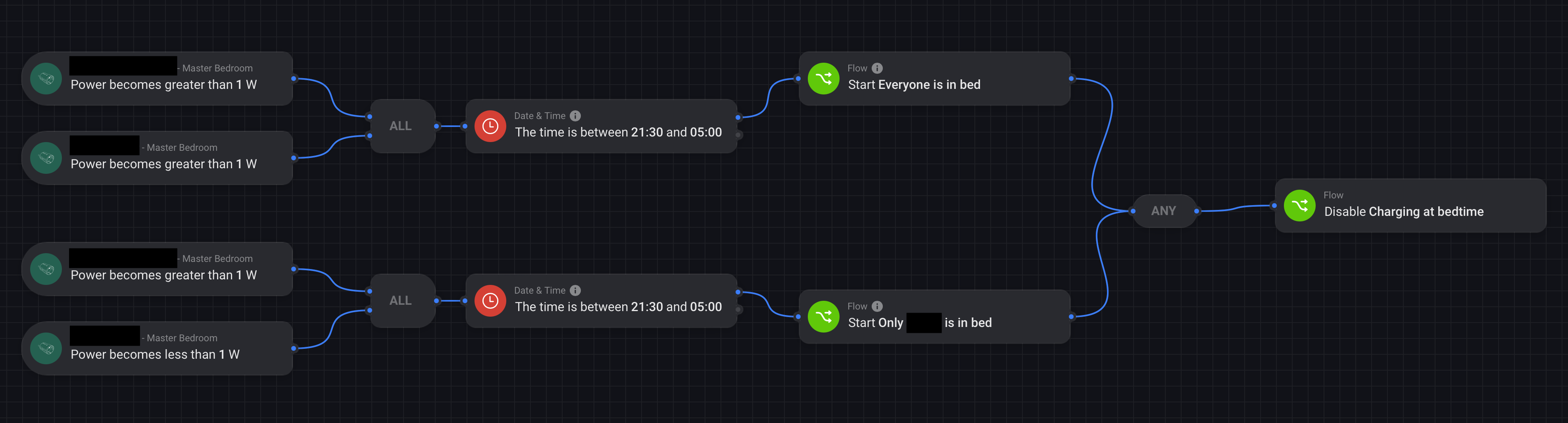

So I tried something like this but I’m not sure that this is going to work with the desired results? Any help here would be appreciated.
I have another flow enabling this flow after 21:00 so that it does not fire beforehand and stay in a constant loop.
NEVER connect to inputs from aan ALL on different triggers! That doesn’t work !
Proof:
Both triggers are executed with Action Top Left and create Work#1 and Work#2 on the Timeline,
However the middle Action behind the ALL will NEVER be activated:

I don’t understand why you didn’t follow my example… :man_shrugging:t3:
No, it’s quite simple like my first sample, but now as Advanced Flow:
I think I missed/overlooked your reply! Thanks for the visualization. Testing it now over the next days.
