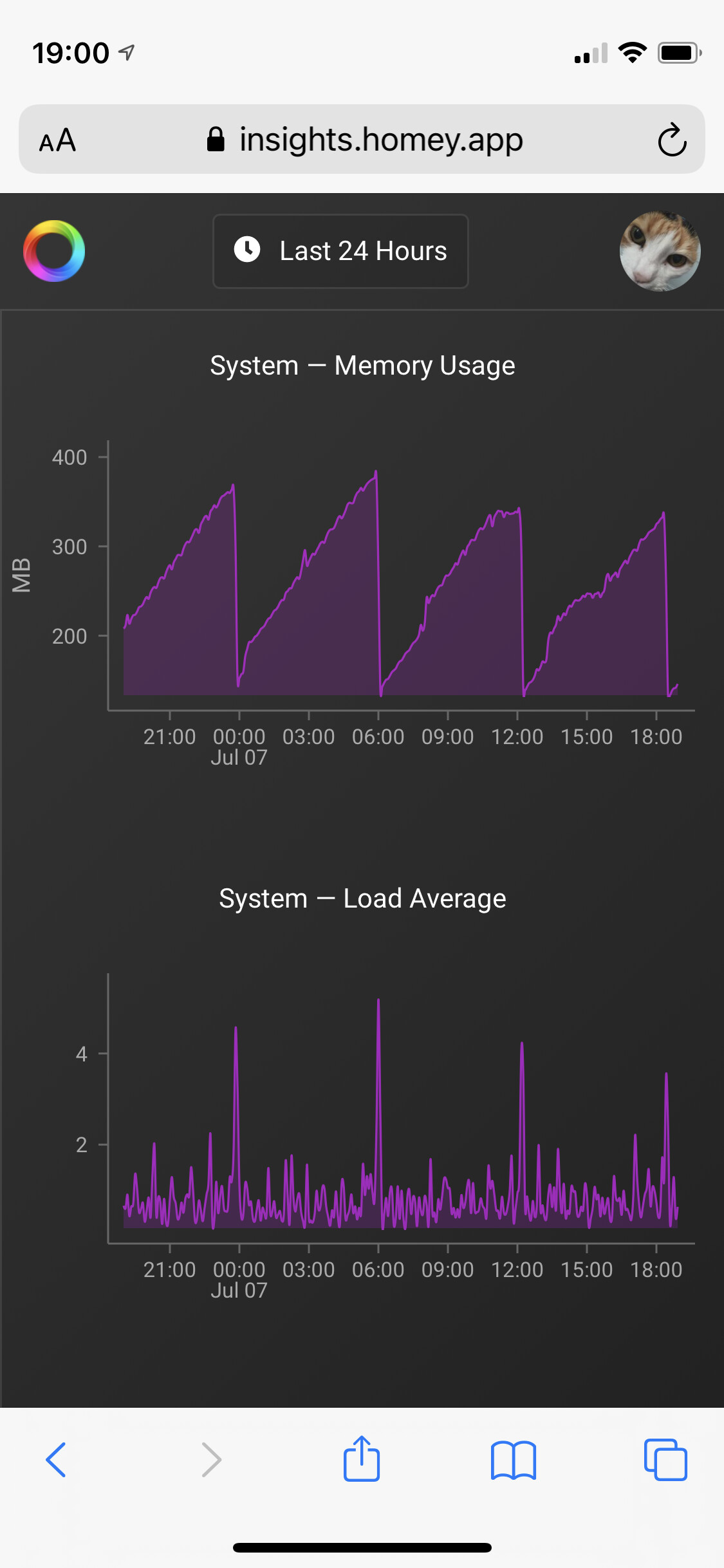

Appears to be a memory leak. Almost exactly every 6 hours it restarts;
My early 2019 (non-pro)

It looks like Homey is rebooting approx 3 times per hour. Not workable at the moment.
I disabled all apps for now and will see how long Homey will run “normal”.
