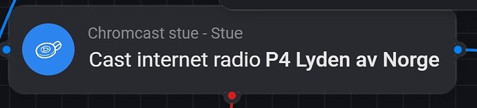

I have been using Then-card Cast internet radio for some time, but a few weeks ago it stopped working and it was no longer possible to select a radio station
Will this be fixed?
