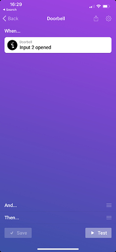

My flow looks like this:

The only workaround so far is used in the flow above, disabling the flow and then reenabling it after 5 seconds. This gives me 2 inputs instead of one which is workable for now but still doesn’t make any sense…
