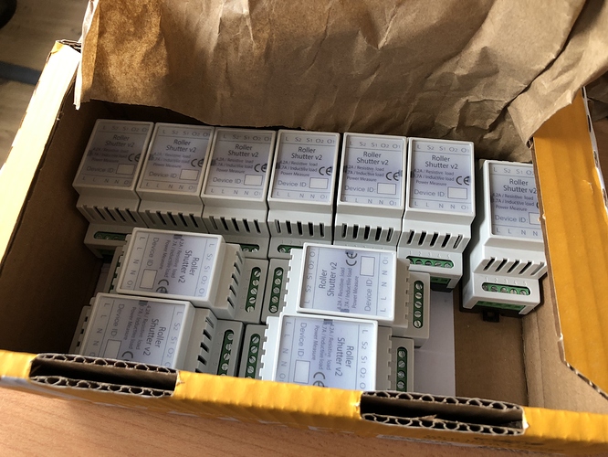

…have just received my modules, what all include 223, instead of 222…
These aren’t the Fibaro Shutter v3 I was speaking of. This is sth completely different
These are… all the DIN enclosures contain a black module, FGR223.
That’s an expensive box :money_mouth_face:
Oh I see. Never came across these.
Did you already try to use them with a regular wall switch at least? If they do work for you there’s already a wiring problem on my side.
Though, what is on the module label doesn’t necessarily mean the device name (fgr223) almost (if not all) all fibaro modules have an internal fibaro device name on the label, the only “real” name is on the packaging, so these will probably include as fgr(m)-222 in homey.
