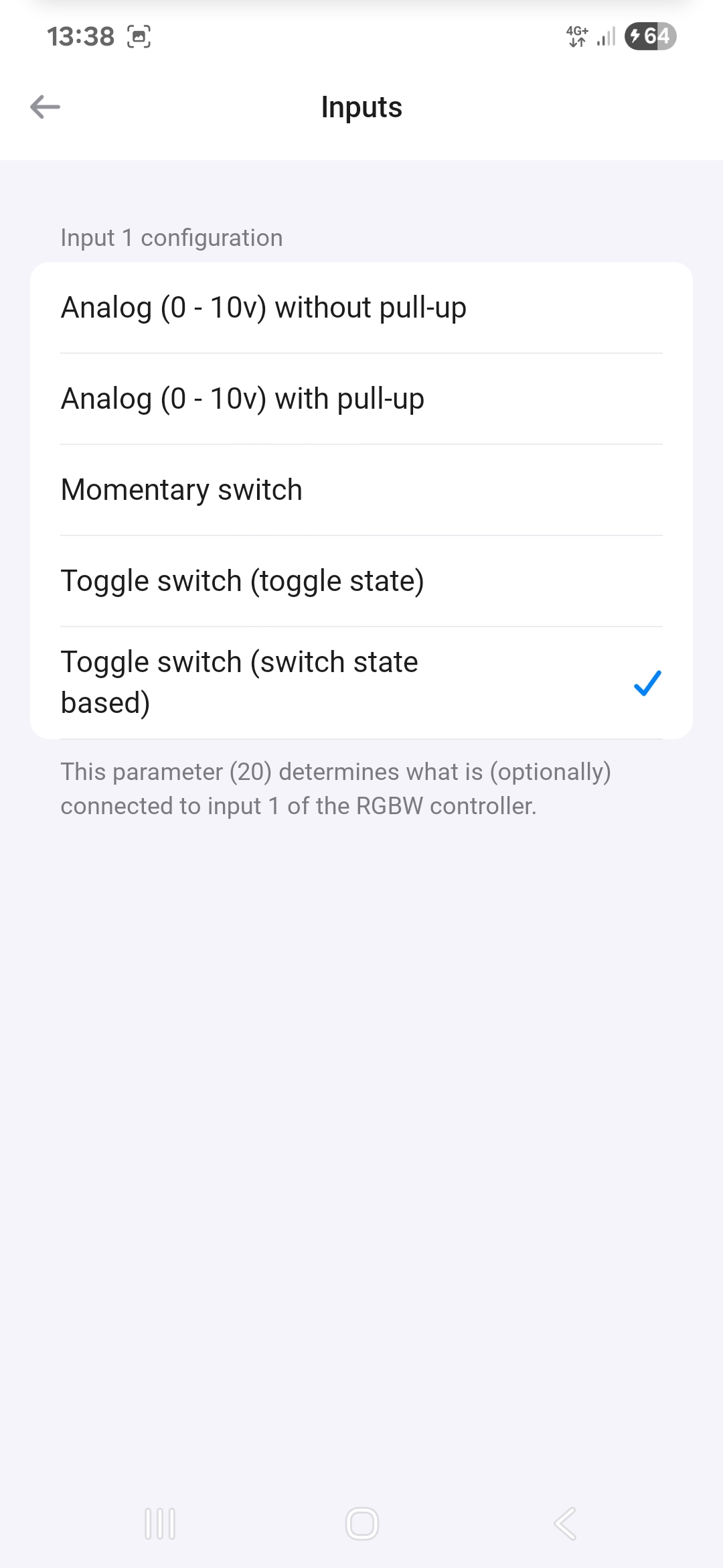

The wall switch is connected to IN1
The RGBW controller is powered from a dedicated 12/24V power supply
The wiring is exactly the same as shown in the official Fibaro RGBW Controller wiring diagram. The wall switch is connected only to IN1 and does not disconnect power from the RGBW controller.

I tested both:
Toggle switch (switch state based)
Toggle switch (toggle state)
Both configurations behave exactly the same.
