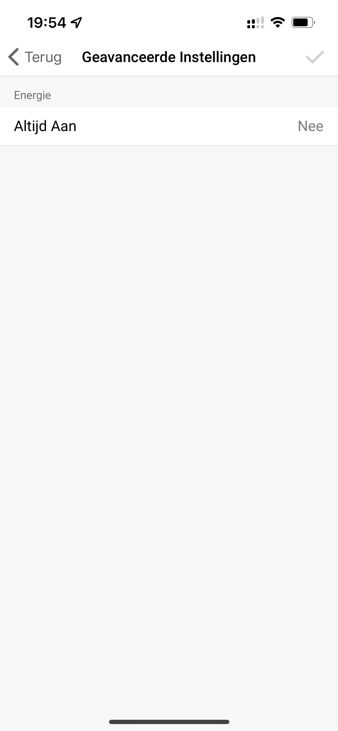

But when I do the same for the S2 switch, there are no settings at all. Even not the S2 related settings, which should be there.

S2 settings, well not much of a settings page
