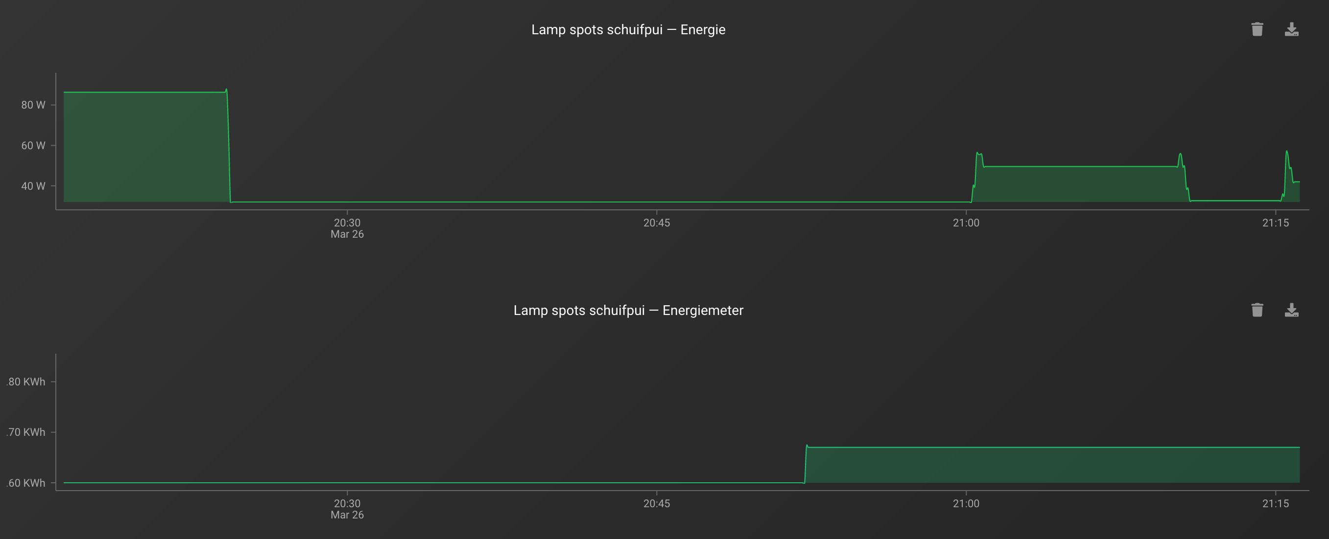

In the image below the power insights of the spots.

What is maybe even more strange is that on the exact same time the spots and the lights in the TV area start consuming more power, the spots in the kitchen start to use less power. All without any action or flow starting.
