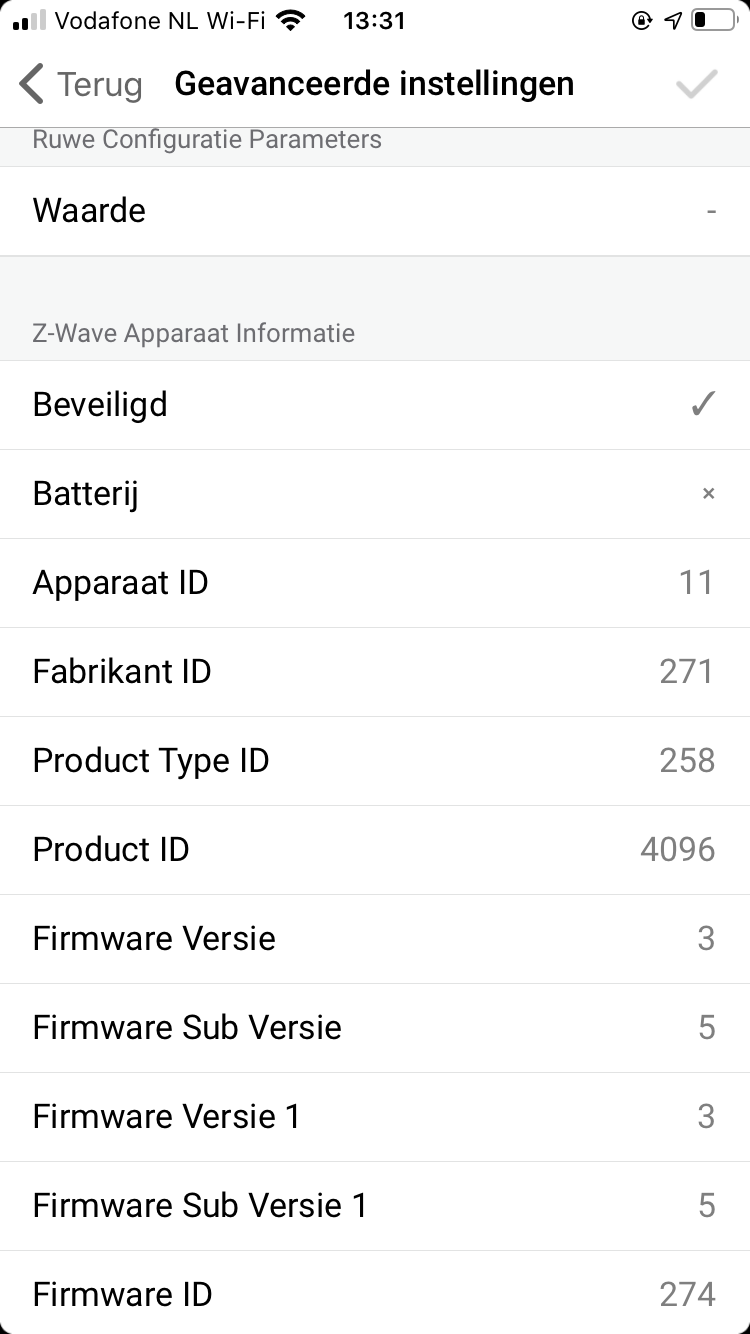

Can you make screenshots of your settings? Including your raw parameters.
And yes, it is set and forget, Homey will not really know if the parameter has been accepted or not by the device, and currently there is no option to ask for that from the device either.
I cannot find a screen where setting of RAW parameters are visible. There I cannot make a screenshot :frowning:
make a screenshot from the page when you have filled them in.
Her some screenshots of my setting……
You did not fill in any RAW parameters:
this where you have to enter the RAW parameters (Waarde) you want to send to your device.
Compared your settings with mine, nothing that is really different. Dim stepping, min-max brightness , … all looking correct.
I tried many times, but this setting does not accept values. I can type them in, but they wont stick and the check-sing is greyed out.
I suspect my Dimmer is disfunctional…

Remove any spaces between numbers and comma’s ( , )

Caseda’s suggestion worked: I can chand raw parameters by leaving out the spaces. Thanks for that.

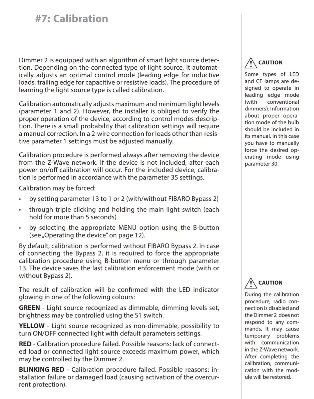

I still think that your calibration is somehow not working… During calibration the Fibaro Dimmer2 will automatically see what range of dimming there is, and this will then be set from 1 to 99%.
Seems that you also force this by 3 long holds of the S1 toggle. Also there is something in the manual about parameter 30 and leading edge dimming. (See below)

I tried Parameter 30 but that did not work. Besides, somewhere on de forum I read that default setting of parameter30 should be default when using bypass 2.
