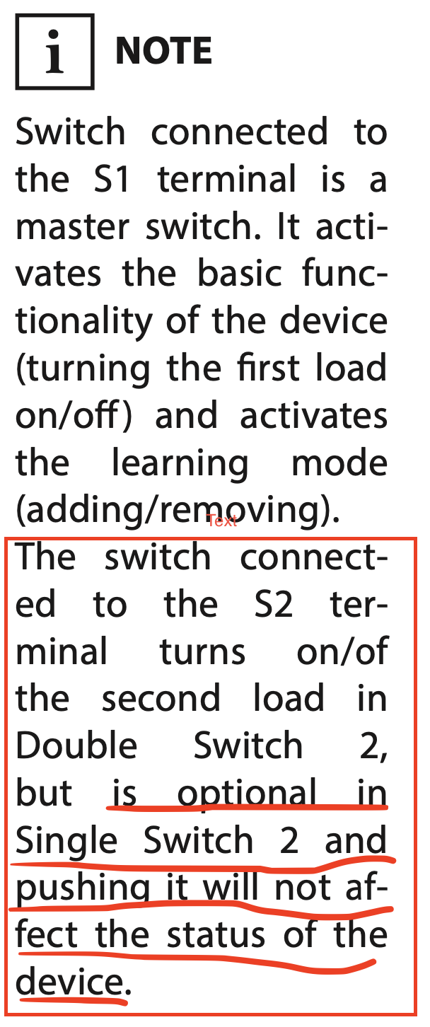

What exactly you are missing?
The Fibaro FGS213 is a single switch.
Therefore you will not find a switch for S2 in the Homey App. A connected switch to S2 send only Scenes to Homey.
By default scenes are deactivated. See manuell Parameter No. 29
Thanks
What I mean is that with power in s2 nothing happens, the output doesn’t switch on
Only with s1
