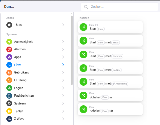

I’m currently using the “Start flow with tag” cards (text, number, yes/no, image) to trigger modular or shared flows — essentially global flows that I call from multiple other flows to handle common tasks.
For example, I have one flow that handles sending a WhatsApp message. Instead of duplicating this logic across multiple flows, I just call the “global” flow using the “Start flow with text tag” card and pass the message. This works well when I only need to send a single tag.
But here’s the problem: if I want to pass both text and an image, it doesn’t work. There is no flow card that allows you to pass multiple tags at once. You can only choose from one tag type at a time (text, number, yes/no, or image), and there’s no way to combine them.

Take a look at Advanced Triggers app :oncoming_fist:
I noticed I already have that app installed (though I’m not sure why). I’ll look into it. Many Thanks!
@Peter_Kawa The image tag is missing, am I right?
Nice. It even has cards with 5*3 and 10*3 arguments
Yeah no image tag. You can discuss possibilities with the app developer in the topic I linked to.
