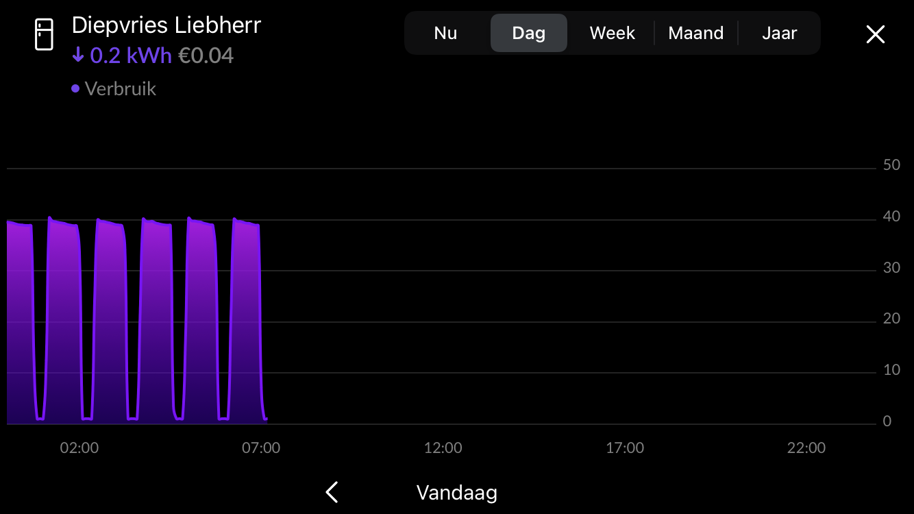

Checkout this one from homewizard:
I don’t need any Smart Plug, @Menne_Talsma is the one who needs one.
But the question is, does the HomeWizard Energy Socket provide live data?
24 hours x 60 minutes x 60 seconds is 86400 seconds a day. :smile:
The Homewizard socket delivers instant information
“Does the HomeWizard Energy Socket provide live data?”
Yes, it does. Every second. :slightly_smiling_face:
