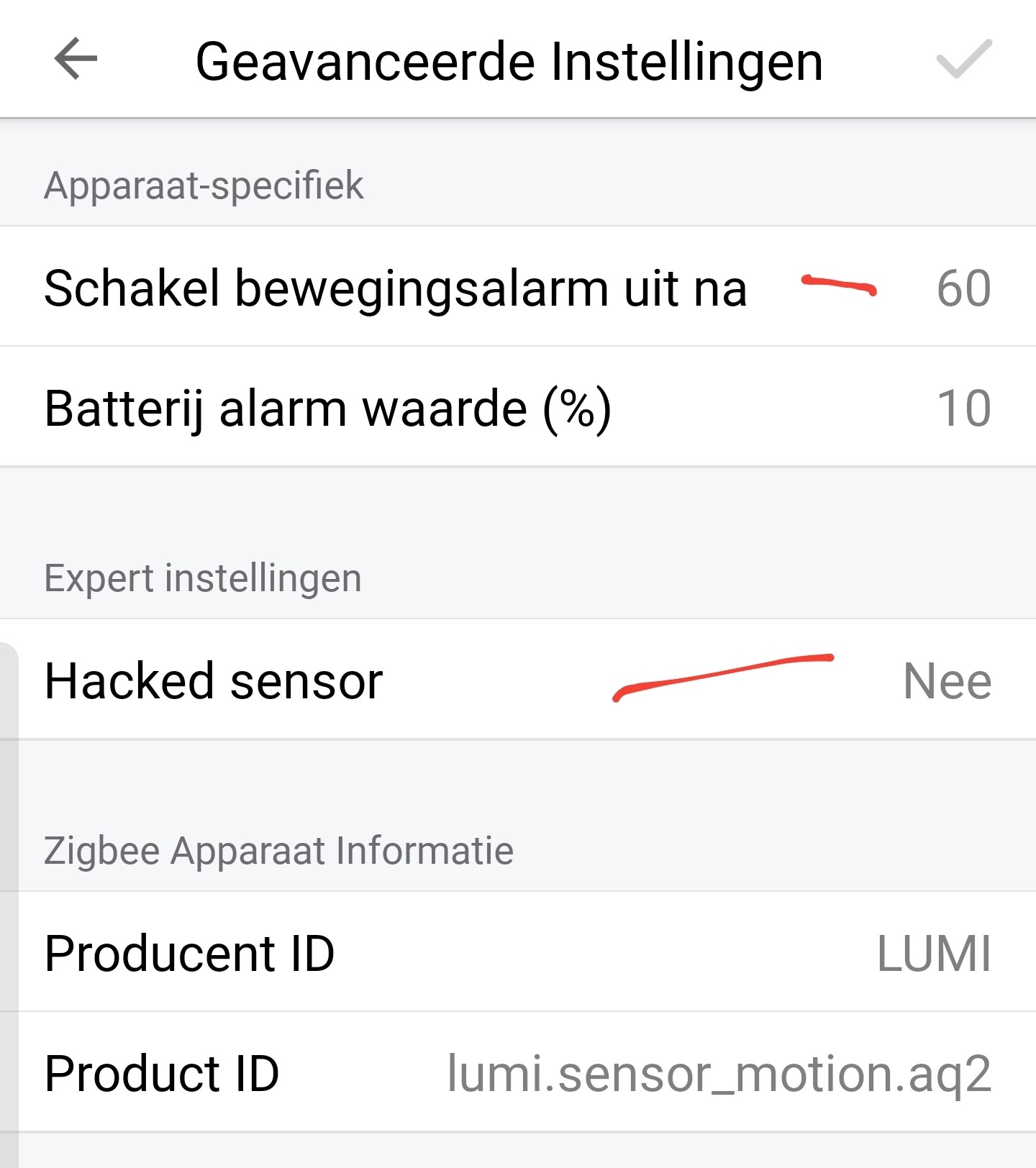

BUT hey, Aqara pir sensors can be ‘hacked’, so the "stay active time can be set at 1sec minimum instead of the default 60secs.

If you set the hacked sensors’ “active time” to 1 sec it becomes a little more reliable.
If that would be 1 sec then it would be more reliable, but not 100% proof.
