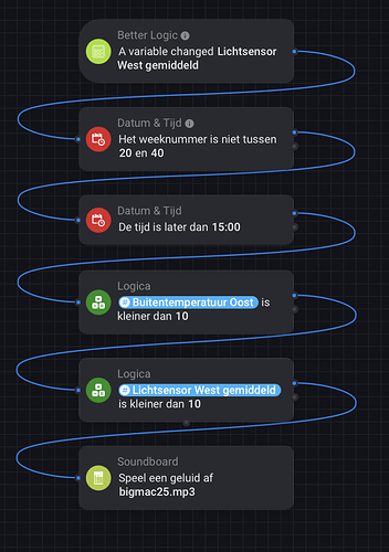

I am enthusiastic about the new Advanced Flows function. But I am wondering if the arrangement of flows affects the processor load of the Homey? In other words: in order to minimise the load would it be better to arrange cards in a certain way? The first screenshot seems to me better in order to spread the Homey load since each card is evaluated subsequently. While the second screenshot evaluates all cards simultaneously. Any more opinions on this matter?
You could test it like this [FAQ] [Advanced Flow] Infinite canvas. Infinite creativity - #42 by Dijker with real conditions but in my opinion it would probably still be ms work. And most likely not noticeable in difference.
