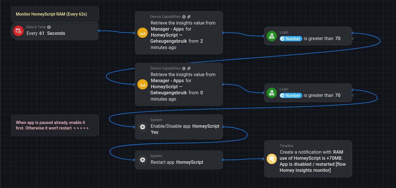

It can be resolved by using the Device Capabilities app.
You can monitor memory usage of apps, and let them restart when the memory use is too high (say 60MB).
