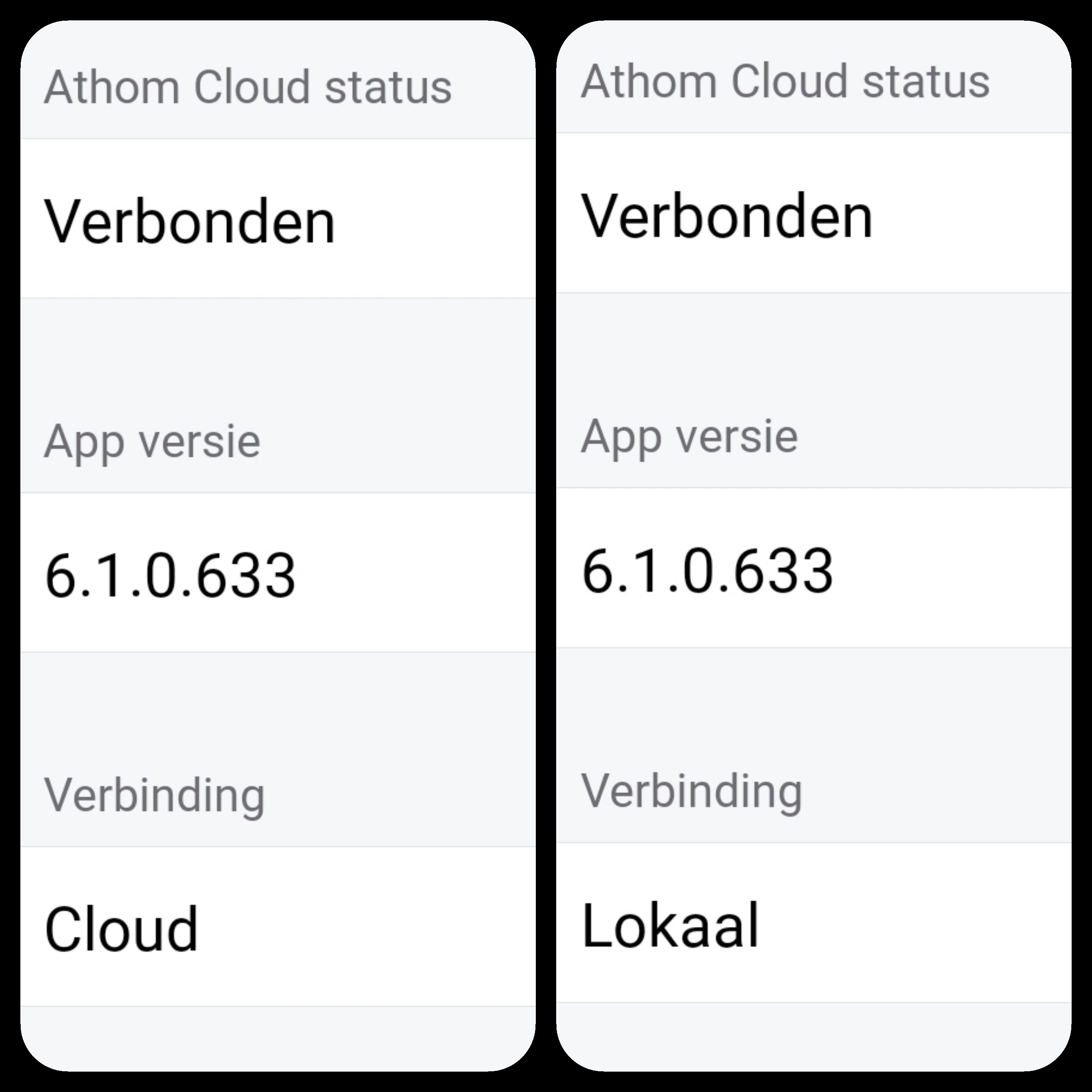

When I’m at home on my WiFi and I open the Homey app, then I see at settings that I have a ‘local’ connection. The same applies when I’m outside my house and I use openVPN to reach my LAN. This feels like a secure connection.
However when I’m outside my house and I forgot to turn on my VPN, then my Homey can still be reached through a ‘cloud’ connection. This feels kind of insecure. I would like to disable that option if possible. There is no need in my case for a cloud connection.
Left ‘Cloud’ connection. Right ‘Local’ connection when I’m inside my LAN using WiFi or VPN.

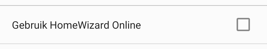

In the past I used HomeWizard and in this app, I could toggle to use HomeWizard online or just offline (local). I would expect to have the same option with Homey.
