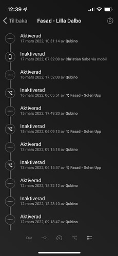

Hi!
Can´t understand this, have a lot of z-wave stuff and this is the first that this is happend to.
Have uninstall and install the qubino mini dimmer but the same is happening.
The dimmer turns on by it self and no flows is working accept turning it off. But after a while it turns on and its not the same time everyday. It says Activated by Qubino.
Regards
Christian

@tobbecokta Did you solved you problem. I have know got the same problem at another house with three diffrent qubino dimmers. And i cant understand why.
I think it changes and started to work again when i replaced to a new battery in a motion scensor that were at 0%
