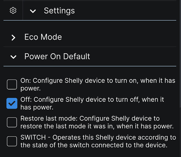

I have 3 shelly 1 attached to roller door motors, they are set to turn off after 0.5 seconds, Button type Detached switch. Power on Default is set to Off. There is a lot in Shelly to be got right and it sounds like you may not have yours set to the appropriate button type

It is attached to a control circuit for a charger. The flow has a time limit so the output is only active during those hours. What button type do you think I should use?
Power on default is set to: Switch.

I have my Shelly 1 set as follows to activate roller door motors, the Shellys are wired in parallel
