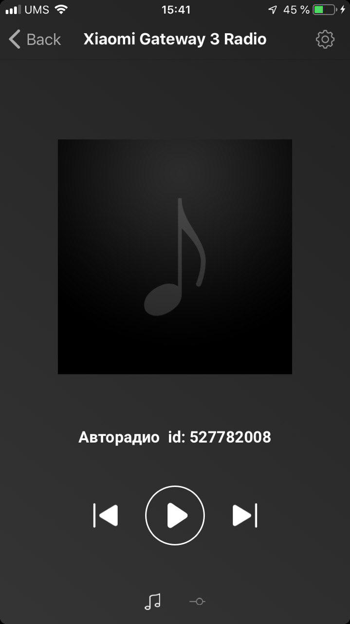

in device.js
const avtoRadioLogo = new Homey.Image('png');
avtoRadioLogo.setPath('./assets/images/radio/logos/avtoradio.png');
avtoRadioLogo.register().then(result => console.log("REGISTER ", result)).catch(console.error);
console.log(avtoRadioLogo)

this.setAlbumArtImage(avtoRadioLogo, true)
not worked
Where/when exactly do you call this.setAlbumArtImage()
? Also, what does “not worked” mean? Do you get errors?
I want to change the images for the album
does not work this.setAlbumArtImage(autoRadioLogo, true)

it’s decided
async onInit() {
this.image = new Homey.Image(‘jpg’);
this.image.setUrl(null);
this.image.register()
.then(() => {
return this.setAlbumArtImage(this.image);
.catch(this.error);
on some function
this.image.setUrl(‘https://www.avtoradio.ru/design/images/site-design/avtoradio-logo.png’);
this.image.update();
