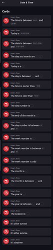

Date & Time trigger card - broken - day of week missing as option
I recently build flows triggered by which day (e.g. weekday) by using built in “Date & Time”, but now option is missing all of the sudden???

Seems like day option is only available in “second” logic check (using AND).
So “first” logic check have to be a time of the day - weekday is not available as first logic check.
This is not very intuitive if you are a regular programmer, and any if/else applies regardless of “order” of check… Anyway, I figured that one out… Thanks!
