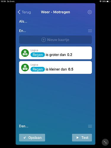

Can’t you just use multiple logic cards for this? Something like
rain is great than 1 and lower than 2
or
rain is greater than 0.2 and lower than 2
It still will trigger every two minutes though if something changed. I’m currently working on conditions for several capabilities so maybe I can do something with this question in mind

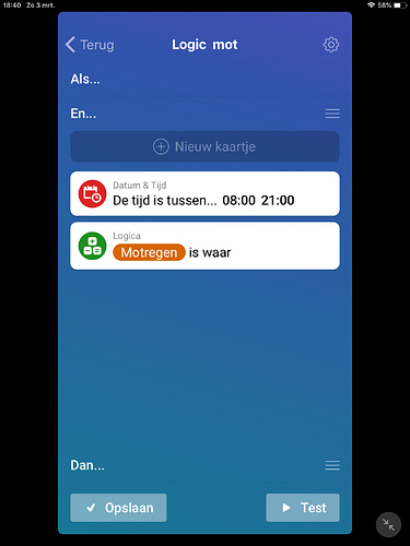

Hello @Jeroen_Somhorst i dont know if its correct, but its working with the logic cards and two flows for each rain type.
I’m getting once a message when the rain type will change.
Its working much better and accurate then the rainradar app or the buienalarm app. Thanks formthe great app

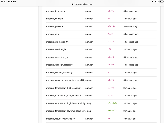

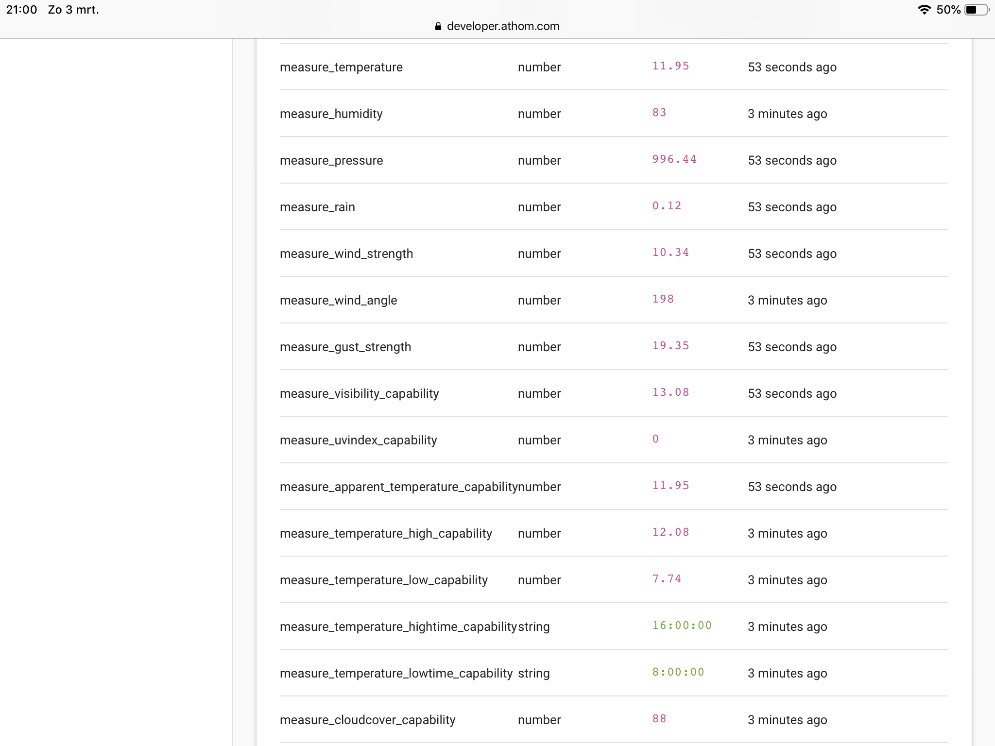

I used the Developer Tool Devices to take a look at the Last Updated frequency. It seems to me that not all of the capabilities are updated every 2 minutes.
Just had some rain, a couple of minutes ago. It didn’t update the measure_rain capability. My coordinates seem OK. Any suggestions?
Mine is working an updating perfect since i installed the app
Did you try to restart the app?
