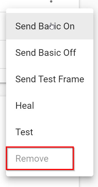

Trying to remove multiple zwave devices of Qubino but the remove button is grayed out. Is there any way to force the remove?
Homey has latest available update installed 3.0.0
Hit the test button and wait for the remove button to become active
Thanks for the tip.
