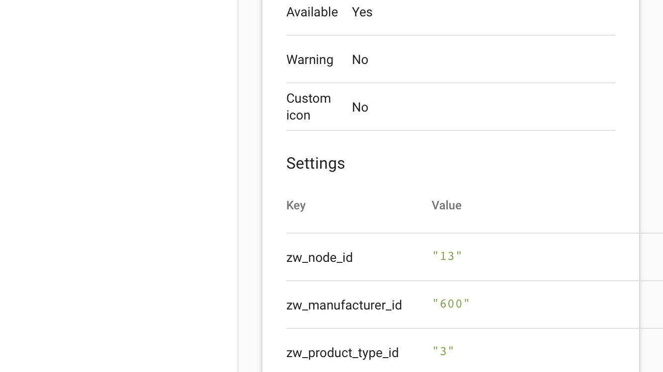

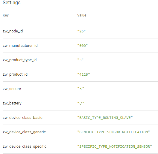

Strange. What does the manufacturer information show on the Developer page? Mine shows:
![image](https://global.discourse-cdn.com/business4/uploads/athom/original/2X/3/371c27eb7b6f039a129cf1b7ebd9403669a08bf0.png)

I have 5 of them (exactly the same as yours according to the screen print) and they work waaaay better than the Fibaro’s i had before that.
