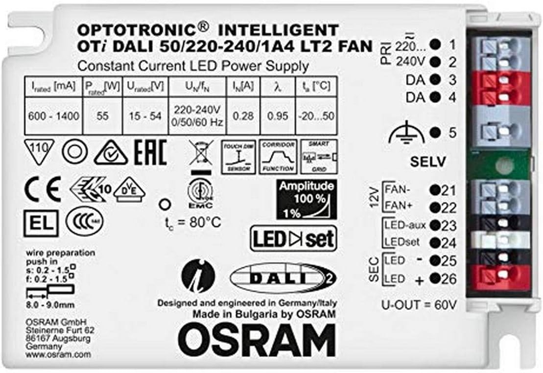

- The lamp has this power supply: OPTOTRONIC® LED Power Supply OTi DALI 50/220-240/1A4 LT2 FAN.

Current thinking is to use the FAN output on the power supply (intended for an optional cooling FAN) to power the Z-wave Dali controller.
