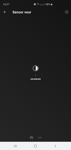

I don’t get any reading from my Somfy io light sensor.
How did you manage to get a reading?
In the Tahoma app it does work but there I don’t need it…

I’ve the sake problem. No luminance data in Homey app but appears correctly in the Somfy connexoon app…
Same problem here no reading from Sunis IO sensor.

I’ve got the exact same issue with the Somfy Sunis IO. They are already part of my sunscreen setup and now I bought the Homey I want to controle the setup with flows. I have two Sunis IO sensors and the sensors can be installed without a problem, but the sensors don’t show any lux readings in Homey with the Somfy app installed. In the Somfy app on iOS, connected to the Somfy Connexoon IO bridge the sensor’s show lux readings and battery health.
Is there a solution for this issue? What versions of Homey (mine is Homey Pro v3.2.0) and the Somfy app on Homey (mine is v1.5.4) do you use when it works in your setup ?
I have a Sunis IO too and it does’t show readings in the homey app.
I did tell Athom But no reply.
In the Tahoma box it works great incl. readings, but I only use the Tahoma box as a gateway, because otherwise my blinds don’t work with Homey.
It didn’t work in any 2.x or 3.x version of Homey.
I did never have an older version.
So, with me it never worked.
