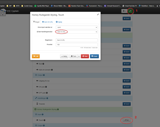

Hi we figured it out - you need to setup a “Gem til URL” and save to the homey (either internal URL or the public webhook url) - like so:
The important part here is the “parameter” where you assign the “event” you want to listen for inside homey and the value - in this example we use the “newvalus” which will send a boolean (true/false) as the “tag” value into homey
Then inside homey create a logic when that listens for the “event” value (in this example “testevent” and then takes the “tag” value and assign it directly to a virtual device onoff value
