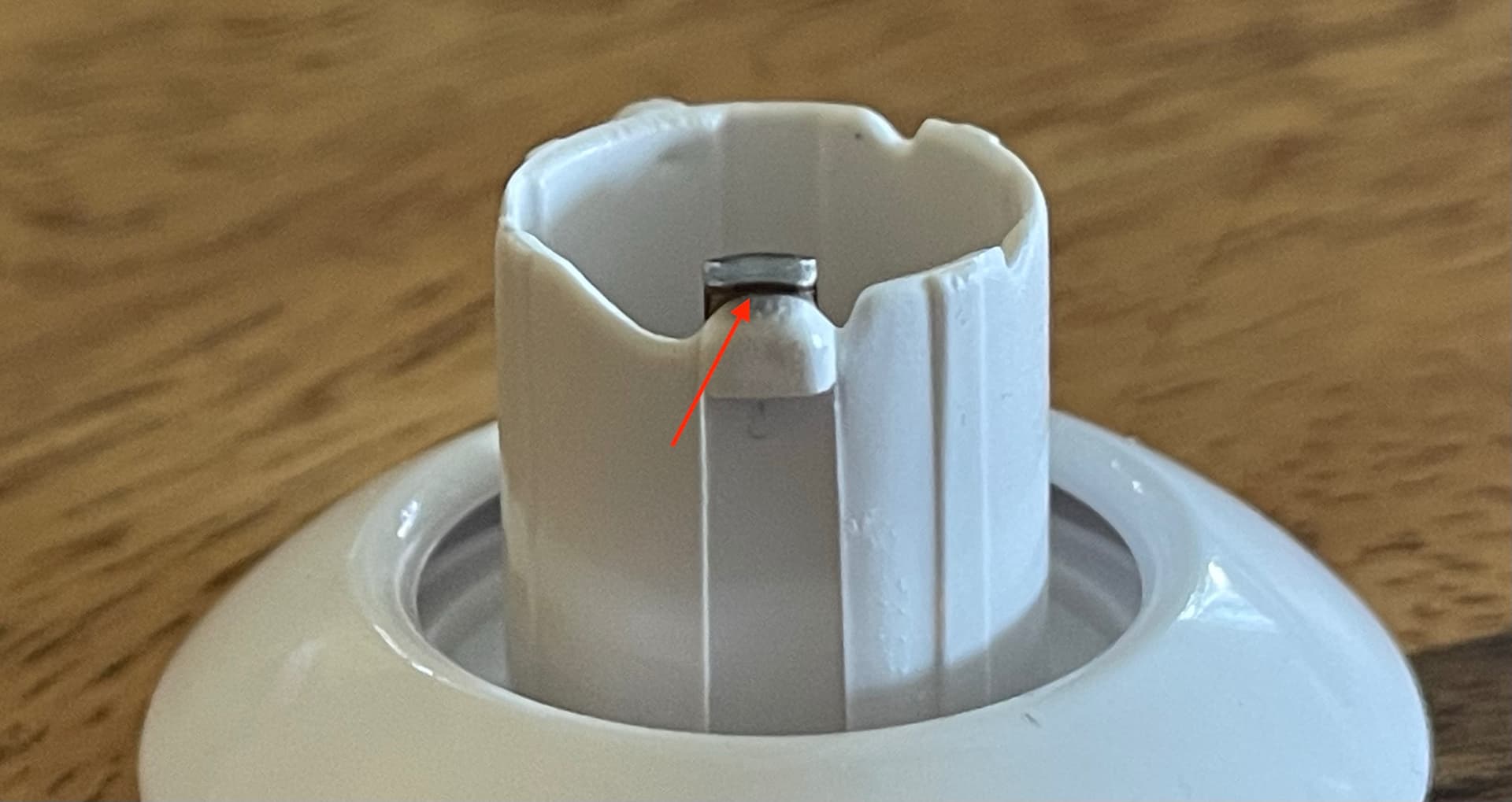

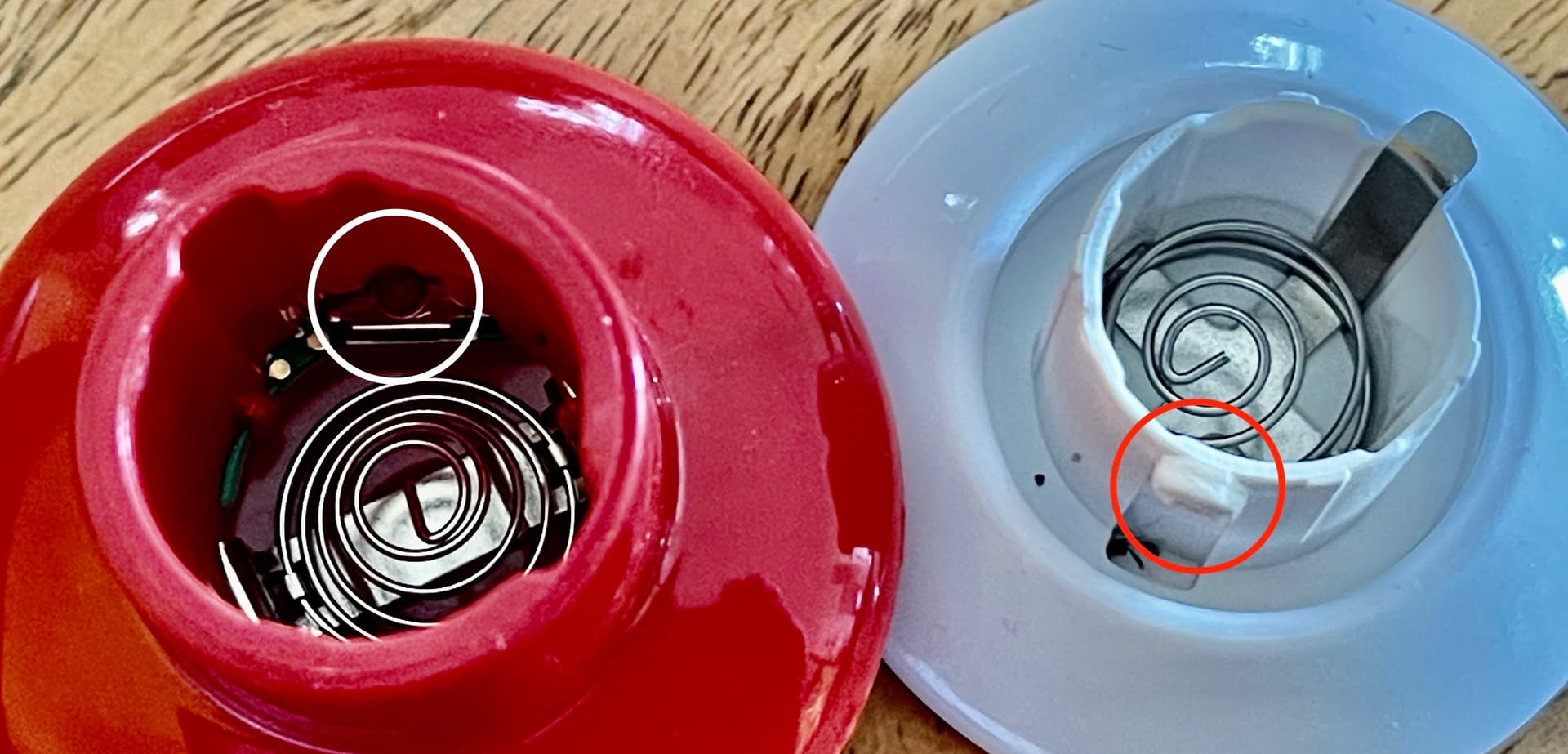

Took a closer look at the button.
First I assumed that the problem is the contacts for the battery:
So I put two paper discs under the framework of the battery spring, so that the battery contact sticks out a little higher from the bottom part:
But this is not the problem.
The problem is the pushing of the microswitch:
The red top of the button must be pressed down extremely hard for the microswitch to switch. Then you can also hear a click. So I tried to bend the microswitch up a bit, but that didn’t work well.
Maybe it would help to raise the pin (red circle) of the bottom part a little bit. However, even pressing the microswitch with a pen, for example, requires a relatively large amount of force.
Any suggestions are welcome.
If this is also the problem with your button, I do not know of course.
