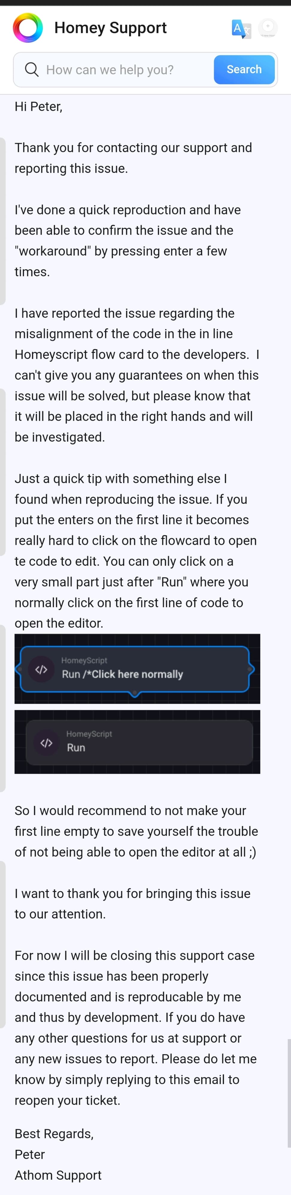

@ all: FYI, I reported the issue to Athom support.
