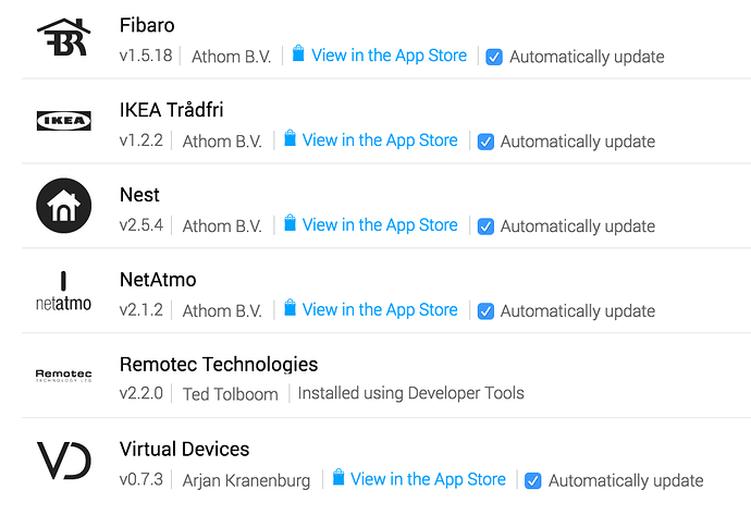

See screenshot, in my case @TedTolboom 's app called “Remote Technologies” has been Installed Using Developer Tools. Just like you did with Aeotec.

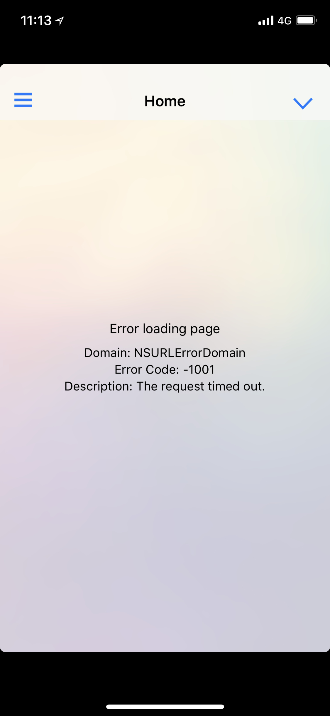

So it’s been a frustrating few days. The garage controller works when initially paired up but then no response via the app, fob key or homey desktop app.
Remove devices and pair up again… starts working and then same issues.
Sometimes error msgs appear. Images attached when trying to just open the homey mobile app.
Any one experienced this? I’m getting tempted to take Smarthomes up on the 14 day return policy.
