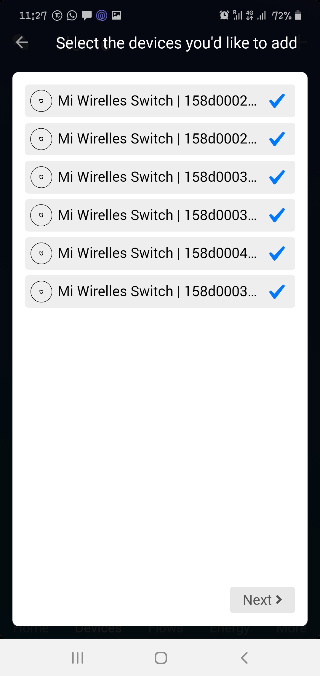

This is the screenshot from homey pro , and homey also same , I check both homey and homey pro all setting is the same.
But the different is I can use homey Xiaomi app itself to connect with xiaomi stuff by click example door and window sensor or wireless switch (screenshot),
then it will show the ip address and tick to choose in my homey ,then I just have to click then it will appear in my homey device And also mijia app . Mean I can see the door and window sensor even the time open or close in mijia app and homey app .
But for homey pro it keep telling me no device is found . (Screenshot)
