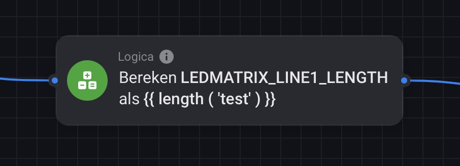

Can the length of a string be calculated in a flow?
For my flow I need the length of my string… is there any way to do this? I tried {{ length ( ‘test’ ) }} and several variations to this but no luck so far.
