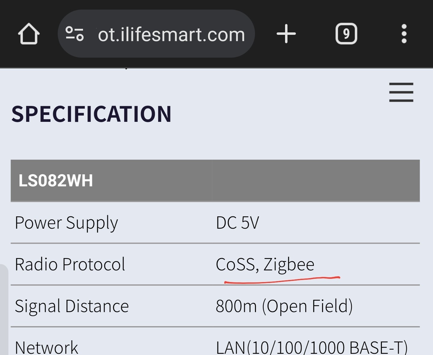

But according to the specs for the LifeSmart products the radio protocol is ‘CoSS’. I can’t find that anywhere in the Homey compatibility list. Actually I can’t find much about that radio protocol at all. Is it some kind of Zigbee standard?
No, it’s a proprietary protocol from LifeSmart.

I saw zigbee as well. Never heard of CoSS btw., but I don’t doubt Robert’s view on it.
Why would they mention zigbee, when you can’t use it on other zigbee controllers I’m thinking…
But, zigbee has nowhere near a range of 800m…
