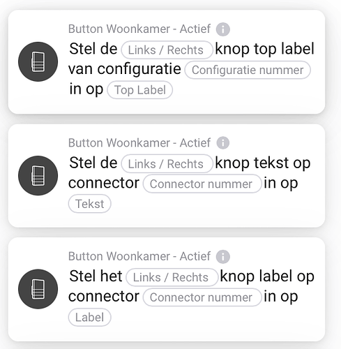

I have three buttons now (sorry for dutch):
One for Top label on configuration number
One for Text on connector number
One for Label on connector number
What is difference between 2&3?
Why difference between configuration number and connector number? I would prefer at least configuration number (as you would guess :innocent:)
Item 3 should probably be Top label, so the same as 1 but for the connectors rather than configurations.
I will add the 4th option for Configuration Text.
Ah, that would be great. Maybe an idea to rename #3 to also “top label”
And #2 and the new one (#4) to rename “Text”/“Tekst” to “label”
That way the naming is the same as button+ configuration and topics

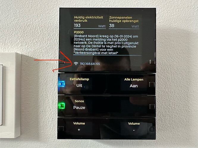

also any idea how I get rid of my ip adres in the display?

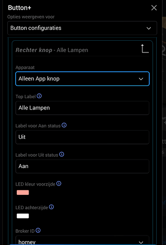

How do you setup the button configuration?
That is fixed in place by the Button plus firmware, so currently no way to remove it.

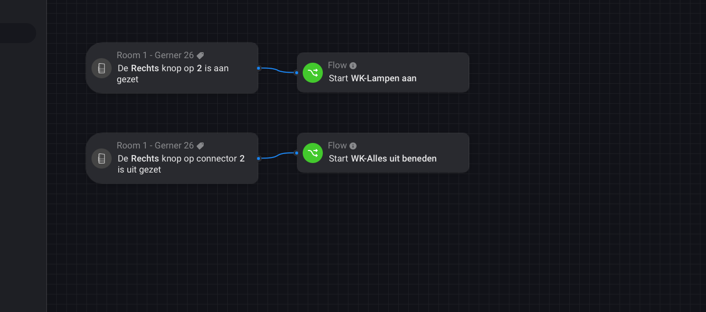

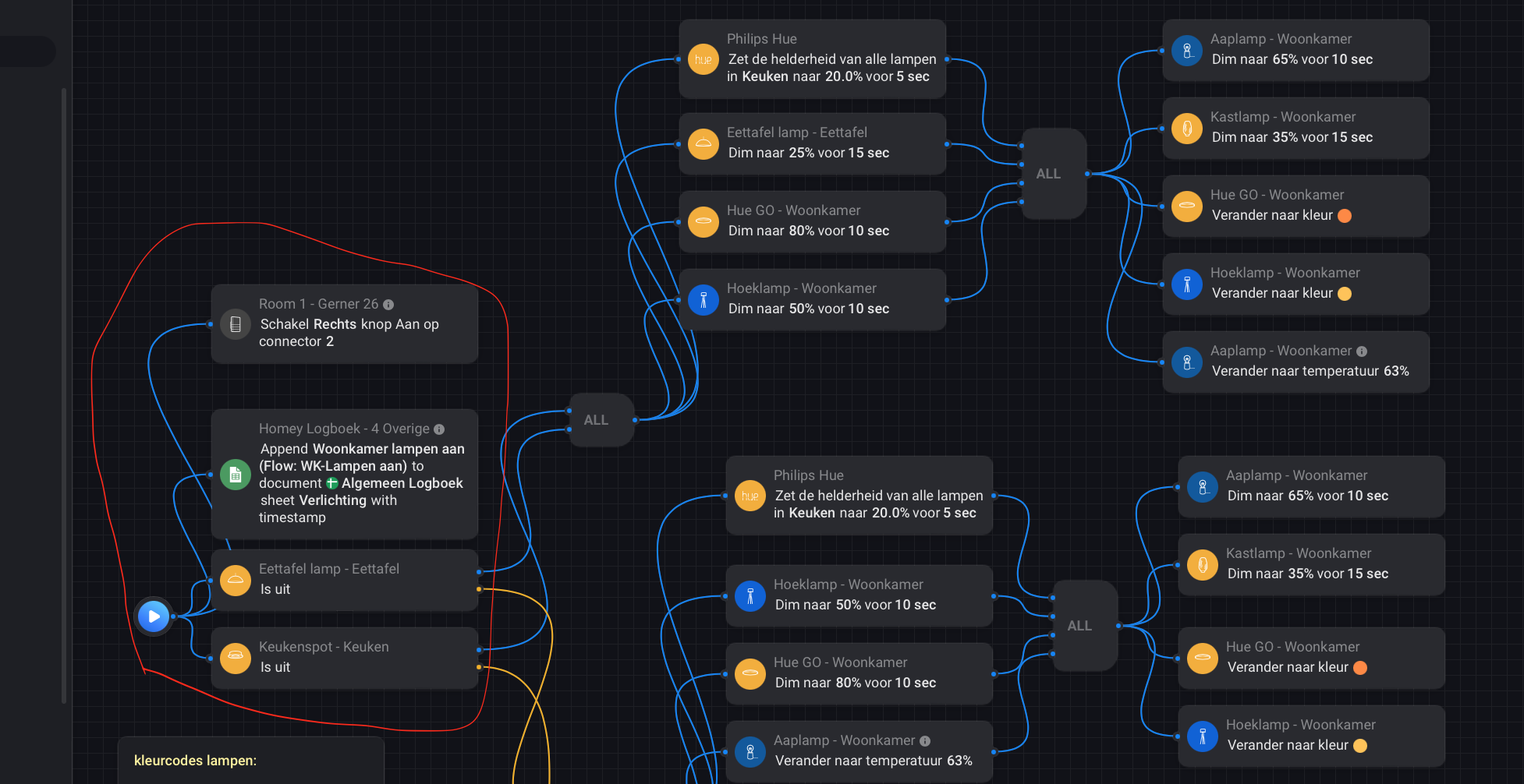

here is the configuration and the flow, because I dont want to change my light flows always for a new device or something I made a flow and with other flows I run the lights flow.
i have put the cart I said to the flow but nothing happens when it triggers not even with a test run.
sorry flows are in dutch.
