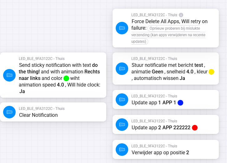

- Create, update, and remove apps from Flows.
- Show normal, important, or sticky notifications. Sticky notifications remain visible until a Flow dismisses them.

1. [Install the Test version](iPixel LED | Homey).
2. Add the physical iPixel LED device in Homey, or add a Virtual LED Screen for a hardware-free test.
3. Use the create/update app Flow cards to add text, image, or icon-and-text content.
4. Open the app settings to upload icons or fonts, or to import a LaMetric icon.
5. Add the Virtual LED Screen widget to a dashboard if you want a live dot-matrix view.
Version 4 migrates legacy settings where possible, but it is a major architectural change. Please verify important Flows after upgrading.

Hey!
You can clear sticky notificatioms only with the card clear notificion as described in the main post.
Clock color is not yet customisable, Ill ad that to my todo liat.
