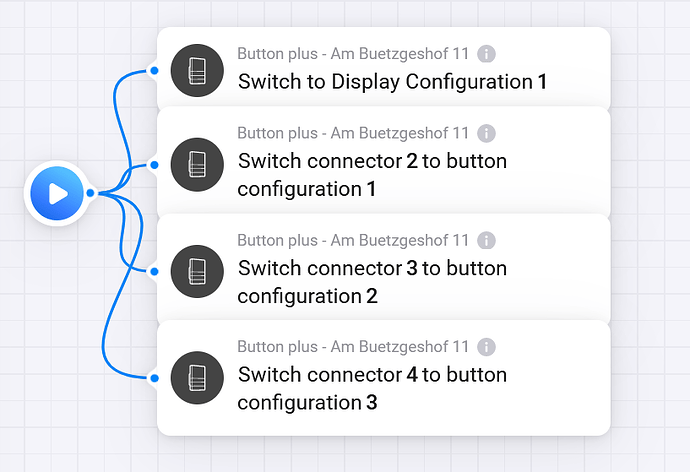

I found that sometimes in testing/rebooting the devices, changes are not applied directly. This might have improved with newer versions of the app.
I created a quick flow which I start during testing in case I feel that the config needs to be re-applied.

Have you checked the Homey Button device settings to ensure you are assigning the configuration to the BAR?
There is also a maintenance option to reapply all the configuration to the device. Maybe I can also add a flow to perform that action.
