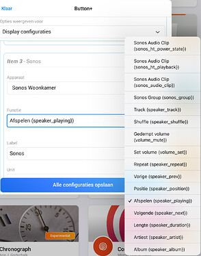

Has anyone been successful in adding info from Sonos to the Button+ display as in the picture above?
I have a Sonos soundbar and 2 One’s in my livingroom and would like to show what is playing when the radio is on, which track is played or that the TV input is active…
I tried all options displayed, but none of them seem to work.
Perhaps a limitation of the Homey Sonos app?
No, just pick the ‘Track (speaker_track)’, that works for me
With my Bluesound I’ve created a text variable with artist and track combined, and that variable is shown on the Button+
This is a limitation of the sonos app. It is only capable of showing the info when you play a song from spotify or apple music etc. No tunein info etc is available.
Thx!
But would it be possible to show the track info here, as well as something like “TV Input” when the sound is coming form the tv?
Or are those 2 variables?
Sure, what I do is I use the trigger to detect that sonos is playing. And then check if the artist or track is empty and the just set the message Sonos is playing. Otherwise I fill a variable with the info from the artist and track.
The sonos “card” in homey has the same issue.
Is the issue getting the information from Sonos or finding a way to send it to the Button +?
The problem is getting the information. Sonos doesn’t seem to send it from TuneIn like for example Volumio does.
