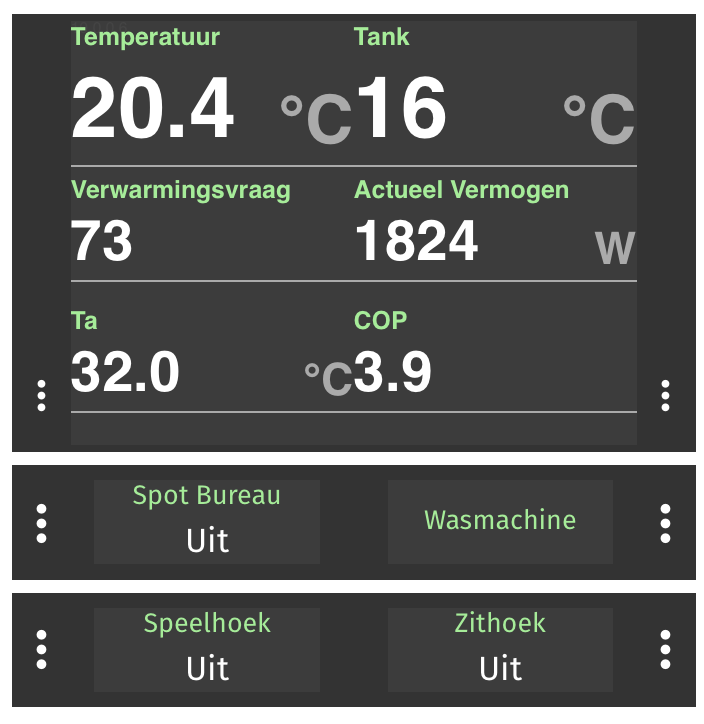

This is the picture of the device

The display doesn’t support the alignment options. The web interface still shows them from an earlier firmware version, but the core was changed.
