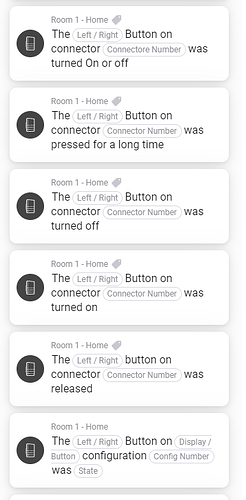

I think this is covered with the new Flow trigger “The < Left/Right > button on < Display/Button > configuration < Config Number > was < State >”. That is tied to the configuration and not the connectors.

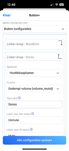

Here’s the screenshot:

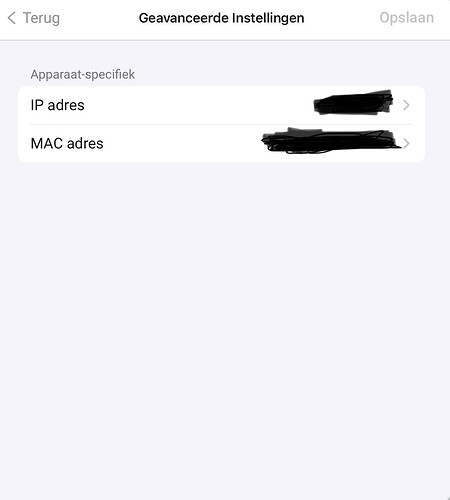

For my time issue, I don’t understand what you mean with the device advanced settings. In Homey, this is the page with device advanced settings:
That’s all I see. Or should I be looking elsewhere?
That’s the correct page, but I guess you are using the last release version. If you install the test version or wait until I get that approved, then you will see the extra options.
For the issue in the screen shot, I can’t seem to reproduce that, so it is either fixed already or I’m not doing the correct steps to get to it.
Could you explain the steps you take to get there?

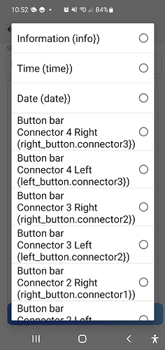

I can confirm, in v 0.2.16 the date, time, temperature and info fields are no longer in drop down of functions when choosing button+ device as device in a button configuration.

They will only appear in the display configuration
The button lists are filtered to only show Boolean and open/stop/close items.

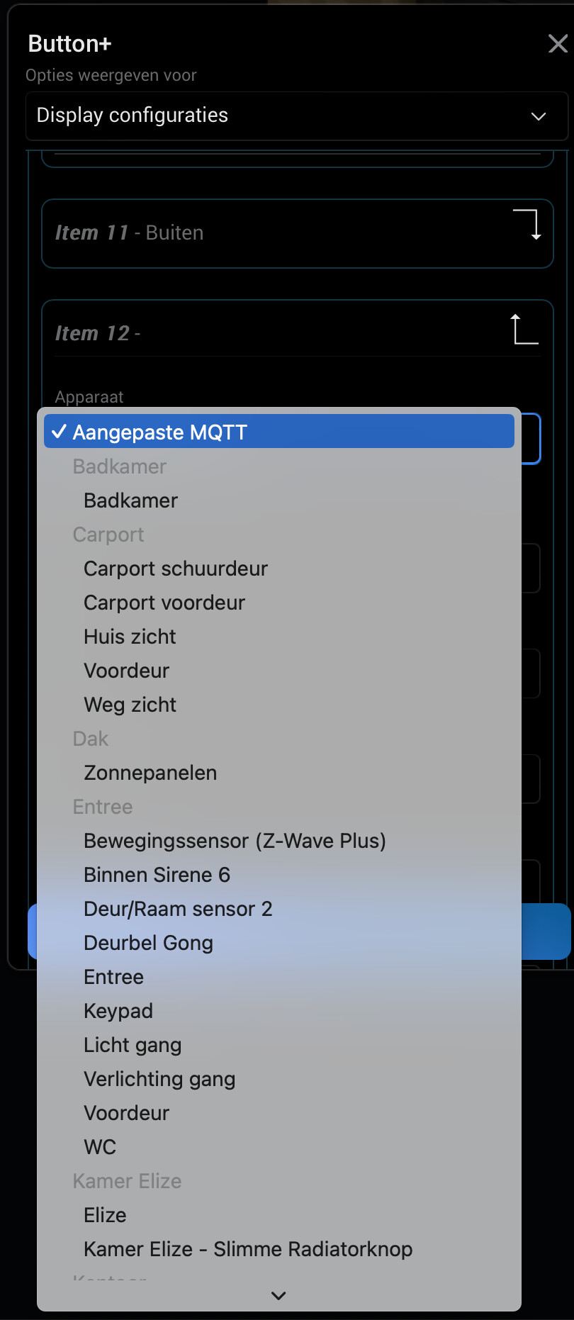

I still don’t see them, they were there before but I have only a long list without the Button+ options.
That looks like the device list, so you need to select the Button + device first, and then the other items appear in the capabilities list.

I’m Stupid. I had rename the Button+ into “Woonkamer” and therefore I was missing it. Sorry!
Now that’s solved, but after I have reset the B+ device (all screens were black and no text ? ) and save the confirguration to the devoid something were missing. After checking my display configuration all the "variables " configured items were empty. And I cannot choose them anymore.
No idea what I have done wrong, but I’m pretty sure on the top of this list the variables was an option:
