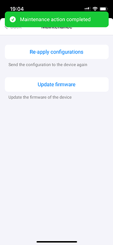

I’m not sure what happened, but my Button+ display was empty except the IP address, the button modules were showing their (correct) values but the LEDs didn’t work, so I reset the device a couple of times and also restarted the Homey app. Nothing changed. I then briefly unplugged the device from its power, and now all display items and buttons are gone, everything is grey.
The Homey app is now also empty and the Button+ Web View was already unreachable for some days:
Edit: I’m aware of the comments above on the 7+ display items causing the Web View not to work.
Is there any way to make a backup of settings without access to web view? I’m jealous of the video of @NoWorldOrder, but gosh if I would lose such an advanced setup… that would be horrible :slight_smile:
There is an import and export option in the App Settings. To backup your configuration, first tap on Export to fill the list, then copy the contents of the list and paste it into a text editor to save.
To restore your back, open the saved file, copy the contents, paste it into the App import and export list and then tap on Import.
Has the IP address changed?
If it has then you can update the Homey device in it’s Advanced settings and Save the settings. Then you can tap on the Re-apply configurations button in the advanced settings to update the Button plus.
Still the same IP… my Homey app now shows all my settings again, but the Button+ display looks like this:
If you perform a factory reset, does it come back to life.
If it does then send the confirmation back to the device in the Homey device Advanced settings page.
@groteberg It’s enough to send the configuration again to the device from the device “maintenance” menu.
That didn’t work unfortunately. At least the device didn’t change
I did do a factory reset, reconnected the wifi and re-applied the configurations from the app:
But the device is still stubborn, now showing its welcome screen after the factory reset
Hopefully that means there isn’t a hardware failure.
If restart the app now does it update?
If not, could you assign an empty configuration to the large display and then reapply the configuration to see if the buttons come back.
I’m still trying to figure out if there is an issue with very large configurations.
Normally, when you see the snow buttons after reset, it’s enough to only re-apply configurations. No need to factory reset etc.
Don’t know what’s going on with your device right now, but for future knowledge or other readers…
