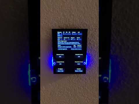

Thank you so much Adrian! I managed to get things going. Still want to do the last few things, but i am so happy of the result already! See my video here:
