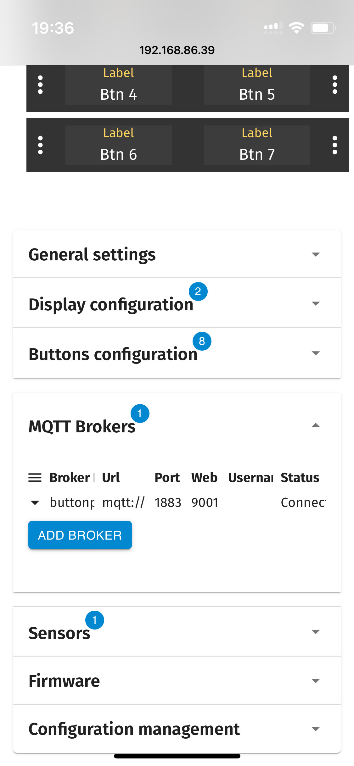

Since I did a factory reset I’m able to access the Web View again. Should Homey be listed as a broker?

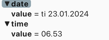

Using finnish locale for date time formating send correct information to MQTT:
Screenshot 2024-01-23 at 6.53.26
However, the display interprets the time value as a decimal number and strips the leading zero and decimal rounding applies. So on the display with no rounding set, time is 7. Should time be sent as a quoted string to MQTT?
I think I will set custom mqtt for date time as I like the ISO format 2023-01-23 06:53 more that finnish format.
Swedes use date time the way I like, but then the weekday names are also swedish Would it be possible that for the device one could set custom date and time formats?
The time is sent as a string, hence you see the leading zero in the MQTT explorer. If I add extra quotes they would appear on the display as well.
I’m no sure what the solution is, but I can reproduce the problem so I will work on it.

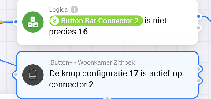

@Adrian_Rockall Just to check, can I do something to provide information about the ‘current display’ and ‘current button’ mismatch?
(When current display is set to ‘X’, the {AND logic check current display’ is always 'X-1). The same for all 3 button rows. (When X is 1, then the readout is zero.).
I’ve got a lot of flows with the rule: If display is not 1, than set to one. Now they are with the offset (if current screen is not 0, then set it to 1). But it would be great if I can fix this.

Just checked. I see now that the Button+ app has also ‘AND’ labels. These are working. But if someone (I did :see_no_evil:) is using the ‘logic’ labels, then they are still 1 off.
Example:
Green in logic (1 off) and black the button ‘AND’ labels:
Ah OK I see what you mean now. Unfortunately, the logic tags are based on the capabilities and internally the app uses 0 based indexes. Anywhere I present indexes to a user interface, I adapt them to 1 based indexes as I have found user don’t like the concept of something like “Configuration 0”. I have no control over those logic tags so I’m not sure of a good fix for that.
