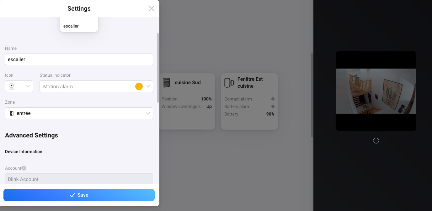

Here is what my camera device looks like
