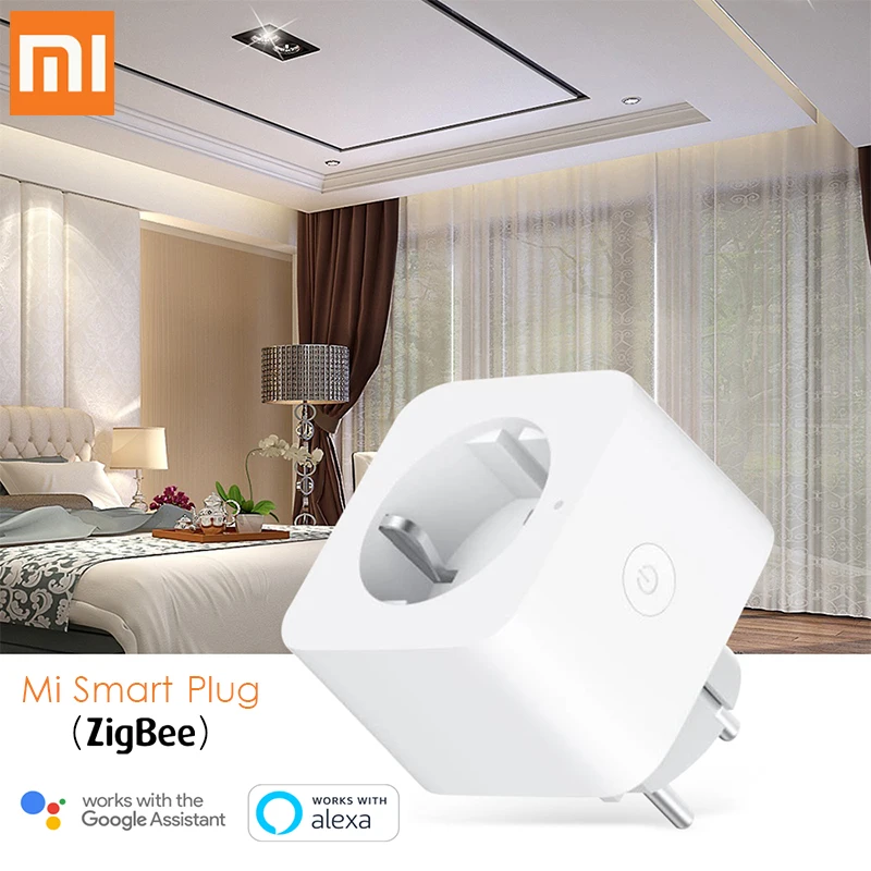

The Aqara/Xiaomi app support the Xiaomi Smart Plug now. Which has energy measuring capabilities. I have one on the wat. Going to try them out. It was around 20 Euro’s on aliexpress.

It is already supported. See the Xiaomi/Aqara app’s device list.
Can’t find it anywhere else. Are you sure these Xiaomi power plugs will measure energy? are you talking about this one:
So for instance, it can recognize when my mobile phone is charging through this smart plug, following which I can make a flow from that?
For instance: IF phone is charging (due to higher energy measuring), THEN mark Joris as “sleeping”.
IF phone is not charging (due to lower energy measuring), THEN mark Joris as “awake”
Thanks for the help!
I personally don’t own that one. I have this one: € 18,49 10% Off | Euro Versie Xiaomi Mi Smart Wifi Socket Plug Zigbee Eu Plug Multifunctionele Gateway Wifi App Controle Alexa en Google Assistent
It measures energy
