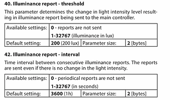

Works fine for me. Adjust the parameters for you need.
Can also be changed.
For me, the Fibaro Motion Sensor is best MS I ever have used.
Yes, I know. The problem is the battery drainage when changing those thresholds. Which brings me to a very important difference I forgot to mention: Fibaro runs on CR-123, Hue on AAA.
