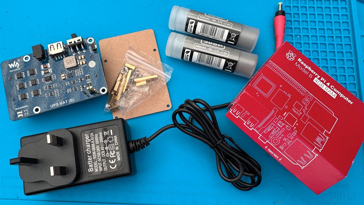

Maybe this could be a solution, if you dare to open up the Homey2023.
Homey’s PCB doesn’t have exposed GPIO pins, so that hat won’t work.
Darn
