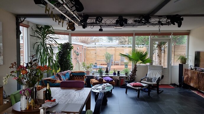

Very interested! Planning to install a full truss in my living room.
Newbe to homey /zigbee/dmx though…
