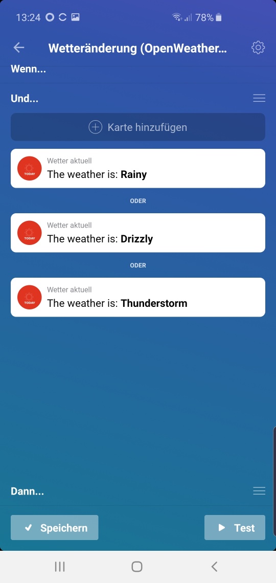

I tried to create a weather warning (for open windows) using this app.
The flow reacts now on cloudy weather conditions, not on rainy ones.
Is it possible, that the app don’t set the tag to the current value?
Do you use these conditions from OWM-API?
OWM%20conditions
So the tag is filled with the detailed description (like “light rain”)? The condition instead is filled with the main description (like “rain”)?
So if I test the flow, I can use the main description as weather conditions for tests (Thunderstorm, Drizzle, Rain, Snow, Clear, Clouds)?
I also have a feature request for your app - for using it for precipitation alerts.
It would be nice if the app could provide a new trigger for changing between “no precipitation” and “precipitation”. So the condition precipitation should combind all precipitation-conditions like rain, drizzle, thunderstorm…
That would make it much easier to create flows for alerts. Now each condition must be checked in the flow and because only 3 OR-statements are allowed in the app, I have to create more than one flow for this…and much more to check the windows state in addition.
It would be nice if you could check if it’s possible.

Hi Ronny,
To be honest, I don’t think the OWM data is sufficiently accurate for your use case unless you don’t mind getting rain through the open windows every now and then.
I think the weather predictions are OK, about as accurate as most other sources (I guess). However, the detailed location based information in the ‘current weather’ table is not very accurate at all in my experience. I only use the app to warn me if frost is predicted in the next 24 hours, I don’t use the ‘current weather’ data at all.
The limited accuracy is the reason I only used the main condition code categories in the app. The more specific codes are like adding digits behind the comma when the accuracy of the number before the comma is questionable (by the same token, displaying the temperature in hundreds of degrees Celsius doesn’t make sense either, it suggests an accuracy which is completely unrealistic).
I don’t know what’s going on with the tag, I would need to look into that.
Hi Anne,
I know the prediction is inaccurate and only a approach. But the last week it was exciting close to the real weather.
The main condition is detailled enough for the app consitions. The details are too much for flows. If needed they can be printet with the tag. Your implementation is really helpful (details for the tag, main for condition).
It would be great if the main conditions could be used in conditions.
I just tested if it could be useful to remember of open windows if weather is getting rainy.
I followed some other OWM values, but the main condition seems to be the best way to handle it. All others are too detailed (e.g. rain in mm).
So I just wanted to inform you, that the condition don’t seem to work. I would be heappy if you could fix it :slight_smile:
Please ask if I can help with testing something.
Btw… what value must be set for testing the flow with conditions?
Is “rain” (like OWM-API) the correct value instead of “Rainy” like shown in the condition , right? That was confusing before reading the OWM-API :thinking::innocent:
