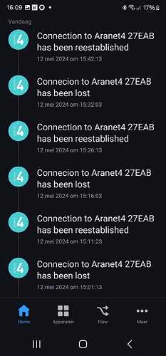

Homey looses connection with the device (which I put 30cm from Homey) and exactly 10 minutes and 10 seconds later, connection is reastablished. Haven’t found out of there is regular predictive connection loss yet. So far no regularity.
Is this ‘works as designed’? What is it that connection cannot remain continuously? Any settings that I should change? Maybe a dipswitch in the device?

I hav a slight clue about the 10 extra seconds. The refreshrate of the device is 1 minute. Maybe it takes 1 second to try to refresh/reestablish connection. If you do this 10 times, it will take 10 minutes and 10 seconds.
This does not solve my issue by the way :frowning:
